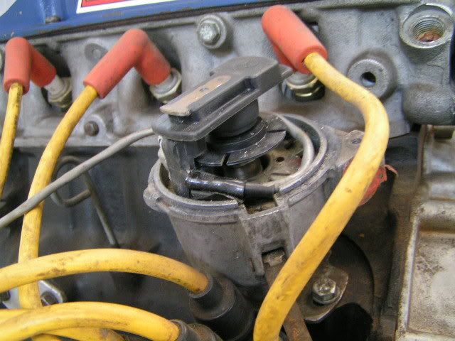

My curiosity was peaked due to a Hunt Magneto's sticker on the A12 motor I picked up. Mine does not have one, was just wondering if anyone knew of one in use. My understanding was as Dodgeman described it, higher voltage output at higher rev's.
I do have an electronic ignition pickup in the existing distributor, can anyone tell me if this is from a different Datsun setup or aftermarket. Any ideas on coil setup to use would be appreciated too.
Engine w/Hunt sticker & electronic dizzy
Ignition pickup
Tell me about your ignition systems.
Thanks!
#7 Re: anyone run a magneto in an A series?
ddgonzal Posted on: 2008/4/10 4:42
That looks like an aftermarket setup -- a photo-optical sensor. Nissan units all have metal inductors with teeth, rather than plastic sensor with cutouts.
I'm using the factory Datsun 1979-1982 style distributor "black matchbox" type.
See wiki - Electronic Distributor Upgrades

#9 Re: anyone run a magneto in an A series?
edp Posted on: 2008/4/10 5:15
After a little poking around on the web DD is right, its an optical pickup.
So what do i need to know to match this up to the appropriate control box? Are they specific to a particular mfg-er or can one use anyones control box? there aren't really any identifying #'s or brand names on the pickup.
Ideas?
