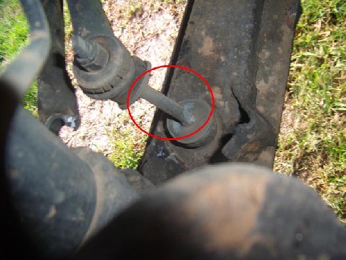

hey mate, wondering if you would have any of these parts i need?
jpg  111.JPG (82.28 KB)
10228_4a29a84b64fde.jpg 653X490 px
jpg  222.JPG (63.05 KB)
10228_4a29a88713a74.jpg 653X490 px
#5 Re: wtb; tie rods
ddgonzal Posted on: 2009/6/6 3:07
Crikey! How'd you break off a tension rod?
#6 Re: wtb; tie rods
jez_120y Posted on: 2009/6/6 12:17
went for a slide in the rain...completly accidental and no drifting invovled.. its been a real pain trying to find the parts so if anyone could help it would be great

If its for 120y then i dont have the Castor Rod but i probably have one of the other things that connect to the sway bar and LCA Never really known there actual name.

#45: 54618-H2300* stabilizer connecting link (formerly H1000)

When you snap off a tension rod, be sure to check the front mount for damage. Many years ago the former wife ran off the end of an autocross course into a ditch with the brakes on full. Snapped of the castor rod just like yours. Put in a new tension rod only to find that the caster was off on that side. Inspection if the front tension rod mount showed that the flat mount plate in center of the mount was bent back 1/4" in the center. Had to have a machine shop turn down 1/4" of the tension rod behind the front threaded portion so I could pull the wheel forward to where it belonged.
