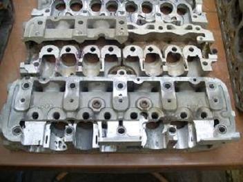

how to stuff heads. all these heads are projects to learn things 25 years of head f##ks. LOT OF TIME/WELDING/COST/DEVELOPMENT/NOT ALL SUCCESSFUL. happy looking. it painful don't cry. cheers PIC 1&2 H89 /PIC 3 GX HEADS /PIC 4 BILLET / 5 & 6 H89. "so if u need any head work or a engine built, I may know where to start" You can look but don't try u will regret the cost.

Holy Crap. You are the Sinner Man, a thousand sins you committed there!!Haha.
Nice work, I see you don't have much interest cutting the heads across the shorter axis? I suppose an engine builder of your calibre would know all that already though.
Pics are a bit small but I can see two GX heads there. All in the name of research though.
OMG.

bige Posted on: 2010/6/3 4:05
that billet never got completed, as you see is wear i got up to. cheers.(somebody out there may buy it to finish)
#7 Re: heads (painful veiwing)
greenapple Posted on: 2010/6/3 5:48
I gotta know. On that first pic, did you machine out the port and insert an aluminum tube as a start at rebuilding a better, higher port?
If that's what it is, I would love to hear everything you learned from that experiment.
And that billet head is an awesome start. How did you plan to make waterjackets? I'd love to hear all about that too...
#8 Re: heads (painful veiwing)
bige Posted on: 2010/6/3 6:00
yes to question 1,major work and cost to get it sealed under pressure test.it flowed great better then any other head. 2. billet was going to drill holes right through and tap end to block off and crossdrill to suit gasket.cheers
