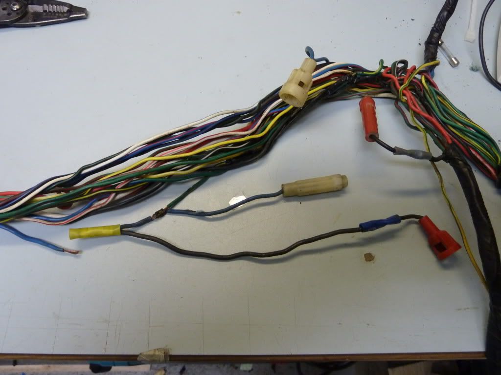

You'd be amazed at how much dirt I've managed to clean out of this harness, cant believe it could of gotten this much in it! So as I un-molest this wiring loom I keep running across little changes that are a bit confusing, I've completely unwrapped it which is a good thing cuz chasing these issues in the car would be a royal pain.

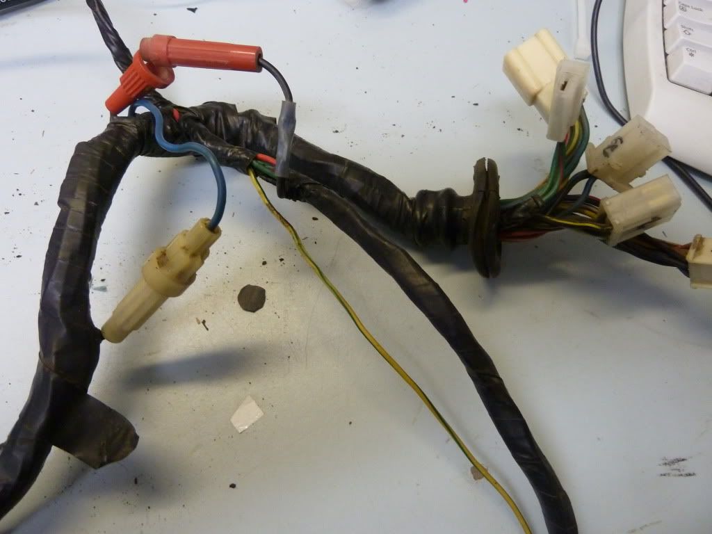

here's part of the loom, this has 2 fuse holders - previous owner must of had another power need, it was attached to the blue switched lead running down with the trans tunnel leads - it was also pulled out of the but connector in side the loom.. I think I'll replace the original white one with a new one as well

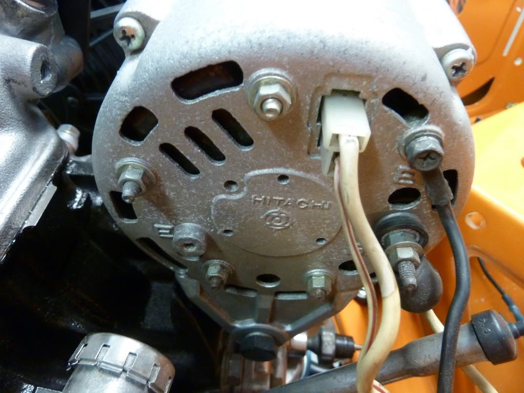

I assume this is a internally regulated alternator....

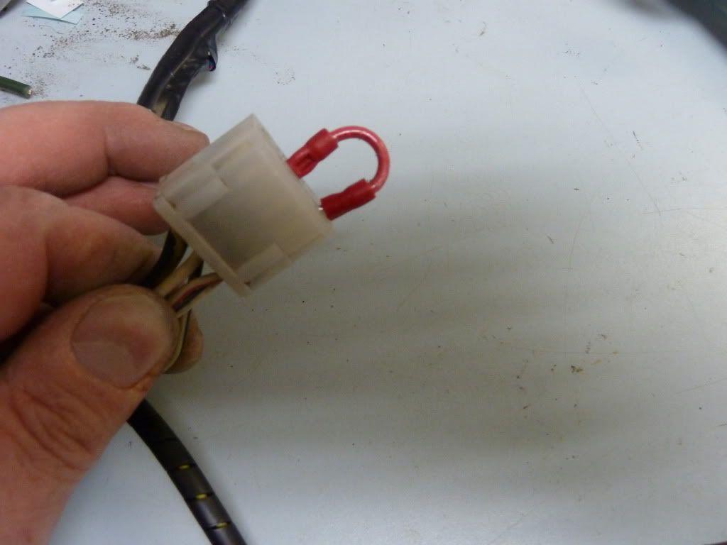

I also assume this is the correct jumper for the voltage regulator... white/black to white/red

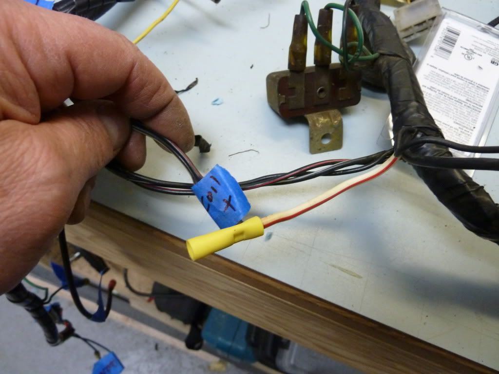

I'm a little confused about this wire, looks like 12 GA. white/red trace located in the coil branch of the loom, I'm guessing this is the alternator feed but as you can see the alt wire is much smaller GA. - is this the charge wire for the battery?
Its a bit confusing but I think I'm almost there is getting it sorted out, if anyone can shed light on the 12GA W/R wire that'd be great.

fat W/R is alt to battery
thin W/R is for charge light in dash
shoul be able to confirm that in the workshop manual wiring diagram

You will require an additional jumper for your socket where the old voltage reg was connected.
The OLD (externally regulated Alternator) had the "N" and "F" connected by the plastic "T" connector.
"N" Neutral was connected by a Y (yellow) wire.
[This is the top of the "T" connector]
"F" Field was connected by a W/B (White, black stripe) wire.
[This is the stem of the "T" connector]
New wring for IR type alternator
Splice the W (white) wire to the Y one. (Sense circuit)
Splice the W/R (white/red) wire to the W/B one. (Lamp circuit)
If you can sacrifice the un-used socket from the voltage reg , its looks way neater.
Also from my expirience [can be very time consuming] is to avoid using crimp connectors and splades. Solder and heat shrink is the way to go. Crimp connectors work but can be prone to intermittent failures over time [very annoying to troubleshoot] and also a small voltage drop can be sometimes be induced due to to poor connectivity.
Also with the last pic, That gauge wire and position is consistant with the wire that connects to the battery via the fusable link. I'm not a great fan of fusable links and replaced that component with an auto reset circuit breaker. ~ 50A from memory. [taking into account that Alternators can spike in there delivery of Amps. For my track car I am only running a 40 Amp unit as I dont have much electrical current draw other than ign and pumps. Rally cars would use larger units to power driving lights etc...

Hey Benny, that W/R is definitely the fusible link wire, I confirmed it on my other loom. I like the idea of a circuit breaker & was looking for the amp rating of the original fusible link but didn't find it in a quick search - I know you said some where between 40 & 50 Amp - I found this...

BTW - took your advise & soldered the wires both together & to the connectors, also sacrificed a voltage reg. plug to make the jumper - worked well.
