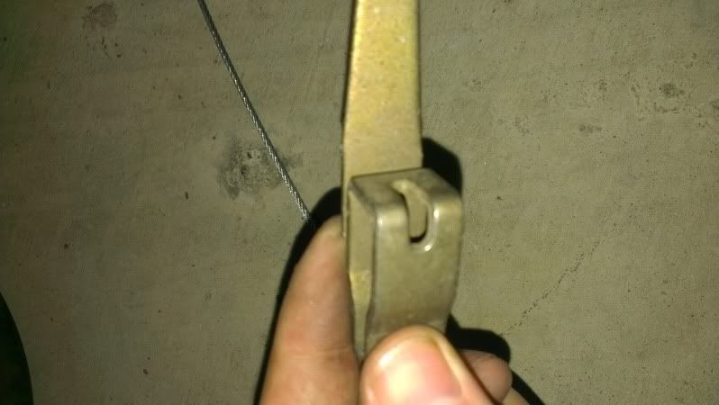

Hey guys,
I'm changing the handbrake cable on my ute but I am a bit stumped on how you attach the new cable to the clevis on the drum brake? Is it a simple method or do you have to solder the cable end back on after putting the cable through? Or was the new cable I bought meant to come with a new clevis attached?
cheers

Some pictures to make it easier!

torin Posted on: 2012/6/22 4:36
on the front face of the clevis (where your thumb is) there should be a bigger hole to allow the end of the cable to slide through
you could just drill out a hole big enough on that side to fit the cable through

demacoz Posted on: 2012/6/22 4:46
I drilled a hole in mine to allow the slug in the side just above your thumb

ayden_d Posted on: 2012/6/22 6:33
Yeah I ended up doing that as I checked the other side and there was a larger hole but missing on the passenger side for some reason.
