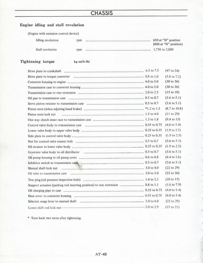

If anyone with an A series Auto could let me know what the stall rpm is on their car would be great.. I do have an old service manual and it says 1950 to 2000 rpm, but that's for a 3N71A not a 71B trans.

My information says 3N71A was fitted to Datsun 1000. 3N71B was fitted to 1200 and other cars.
Model: 3N71B X0100
Converter: 10-C
Stall Revolution: 1750-2000 rpm

Thanks heaps, I was hoping it was going to be a little higher..
