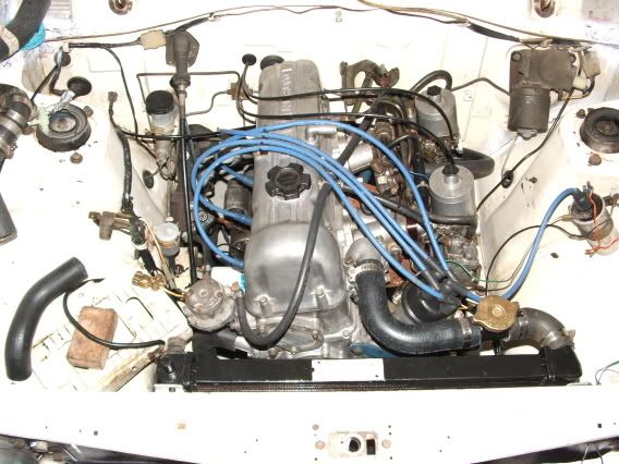

Got the L series running on the weekend!
Gave the engine a quick tune before i was off fishing for the avo, will be on the road this week! Sounds so grunty compared to the a-series. Cannot wait, only got a 10inch thermo on for the moment, with the rad i have im sure overheating wont be a problem, will see when summer comes.

Is the radiator cap in the hose so the bonnet will close?

Nah the radiators a Saab 900, they have a cap on the overflow bottle and its filled from there but i just bought the inline filler when i got the radiator recored.
Bonnet clearance is about a 1 and a half inches on top of the rocker cover, which will be handy if i decide to go L20 at a later date.
