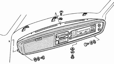

Re: 1200 sedan gauge cluster!! help
Hi datsolady,
Pictures and information on removing the dash are here: Dashboard Removal And Reinstall
Example:
etc. You can decide from the photos whether you can get the gauge cluster out without removing the dash. My experience is that it is much easier to remove the entire dash.
Are you in the Seattle area? I might be able to help, I've removed and reinstalled gauges a few times now.
