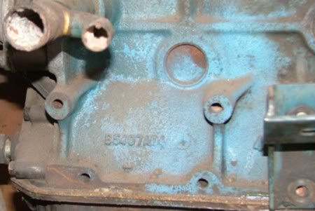

When the block was redesigned for the air conditioner mounting ['74 & on] they cast three mounting lugs on the crankcase & drilled two more holes on the thickened pan rail to take the mounting plate, but this one was cast without the center lug on the crankcase. It's an A12 & I guess that we could speculate that it is a very early example, but I don't know for sure.

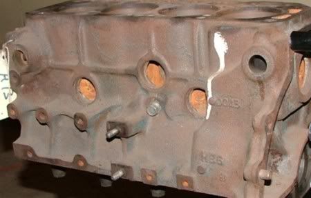

This is my A13 block & the third mounting lug with strengthening ribs is clearly seen. This one is now sitting in a recycling tub filled with diluted molasses.
