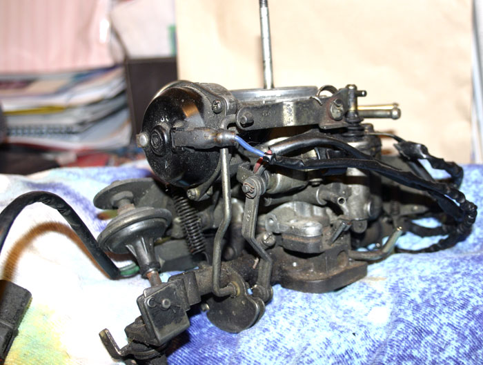

anyone got info on this carb?
2005/8/8 9:38
From The garage, NZ
Posts: 1922
Hey all.
Looking for info on a carb that i got with an a15. just wanting to know, will it work with A15 without mods, etc etc.
Selling my A15 and this is the only carb i have with it. Im thinking its off a late model sunny? has heaps of wiring on it which un-eases me as a series are ment to be bsaic as basic
Cheers guys

Looks like a A series carby. By the looks of it it has Electronic choke and lots of wanky emissions diaphrams... should work on a A15...

looks like it also has an electric anti dieseling solenoid and a thing that brings the revs up a tad when the air conditioning is switched on.
I have the exact carb sitting in the shed

I've never seen one with a solenoid on the throttle body plate (bottom of carb) like that.
Can you read the carburetor model number?

where abouts is the model number written ??
Could all that crap just be removed and used on an a15 like a old style carb?

It looks like a late model emmissions carb off of a late black top A15 from a Vanette. I would like to be more sure but I always rip the buggers straight off and throw them away...

model number is on left side of carb body:
Hitachi ID Boss
Most of the time you can't remove all the emissions stuff. But don't worry it doesn't cause a problem. Just plug the hoses, none of them need to be connected.
However, in a street car you'll get better performance if you connect the vacuum advance port to the distributor.

carb actually doesnt have a number
Where its ment to be, it has a vacum daiphram over it and under that it only has what looks like a 3 inside a crazy circle.
Wierd.
Im selling this carb. What do you rekon i should say about it ??

If it came from an A15, I would put it on and drive it.
