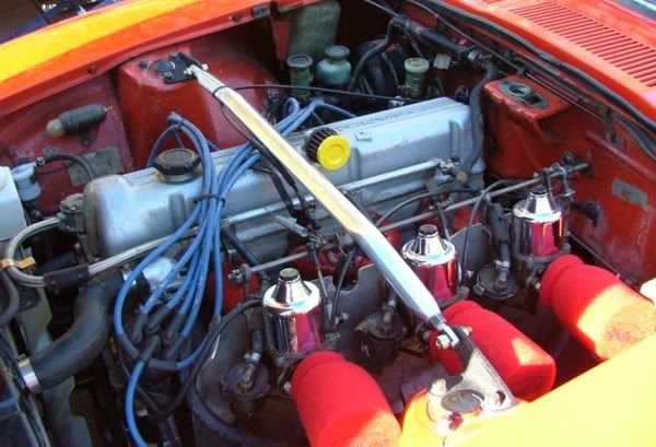

Sorry, I remembered this photo from the Goulburn Datnats & forgot about the other stock ones.
