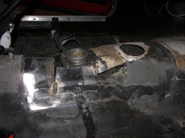

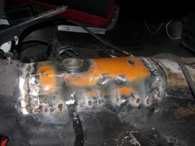

exactly what sooty grunter has said, i cut around the shifter bit and welded in a new peice but the rest of it is just massaged with the hammer. i also need to remove the motor and box to do anything to it. if you have the time and patience replace the tunnel with a bigger one. heres a couple of pics of mine
Posted on: 2007/5/24 9:18
