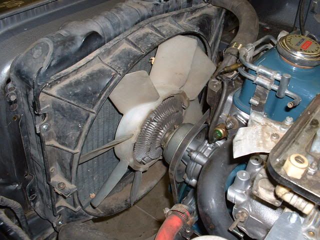

As the title states.
Yes or NO?
Here is the deal... I bought a waterpump on ebay $9.00 ...months ago. Turns out, it has the wrong bolt spacing for the stock fan, but for some reason I had a pulley that fit it. I picked up a used clutch fan. 8 bladed and fits inside the factory shroud.

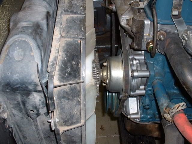

Well it fits great, no closer to the radiator than stock. Acts like it works well.
I am getting ready to start the New engine today. (Keith Dots) 0 mile engine, cam'ed up a bit, A15 intake and header/extractor. If I can get DD's SU intake to replace my broken one I want to go that route.
Oh and its supposed to hit 100* Fht this week. too hot for me

Now you surely know by now that the payment for all this great advice is that you have to post a picture or two of this setup.
I would like to run an aircon water pump & fan in my car & a couple of pics would be great.

Paid in full! LOL
the clutch itself was in the trunk/boot of a 240SX. I got the fan off of a Datsun pickup 80's era.
OH BTW this is in my B210
