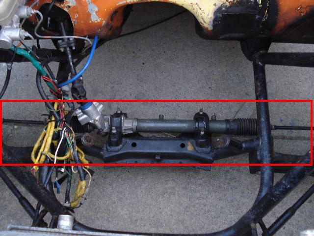

My brother is determined to get me to swap out the steering box in my 1000 for a rack similar to what IAMDVS has in the photos of his project (I hope you dont mind me borrowing your pic IAMDVS)
Has anyone done this, or doing or is it only possible with lots of money?

Hi the front end in my photo you will find will be to wide ( as i found in my new project) but found an nice little link that you might help or might not.
Shorting steering racks
Posted on: 2007/8/2 14:42

I'm doing this same mod to a 120Y so support an engine conversion. I found a local that is parting out a gemini that has rack steering (apparently a close fit to a datsun) so with any luck I'll have that this weekend and can post some pics and measurements for you also.

what is that steering out of? i have a suzuki ute rack and pinion in the shed, too much f@#king around to put that particular one in, what is the one in the picture from?
