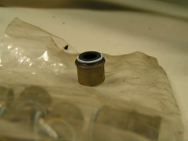

I know this is a valve stem seal but I've never seen one with a metal base, their obviously brand new. Anybody know anything about this style?

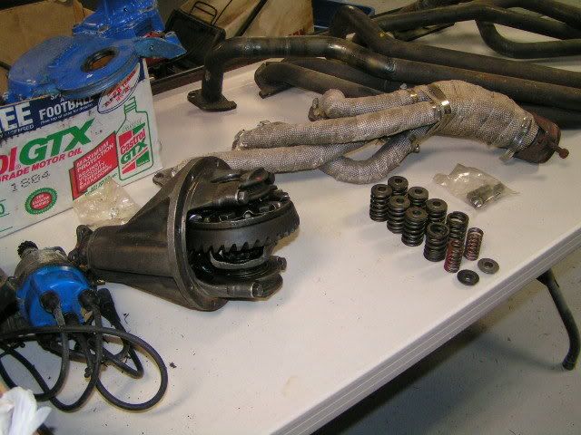

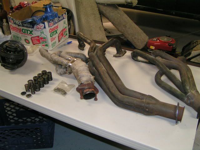

heres the load of stuff I picked up today
[img] http://i253.photobucket.com/albums/hh56/evanp1200/PICT0356.jpg[/img]

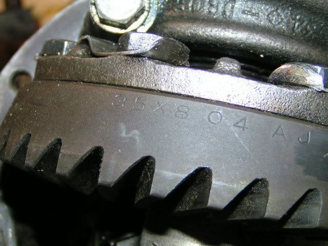

heres my new (old) 4.38 rear end
[img] http://i253.photobucket.com/albums/hh56/evanp1200/PICT0357.jpg[/img]
I even counted the teeth to make sure

The guy I bought this stuff from said he bought all of it from Datsun comp in the 80's

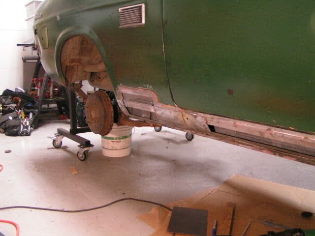

heres one of the rocker & rear lower quarter being repaired

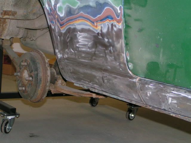

here's one after the patches have been welded in

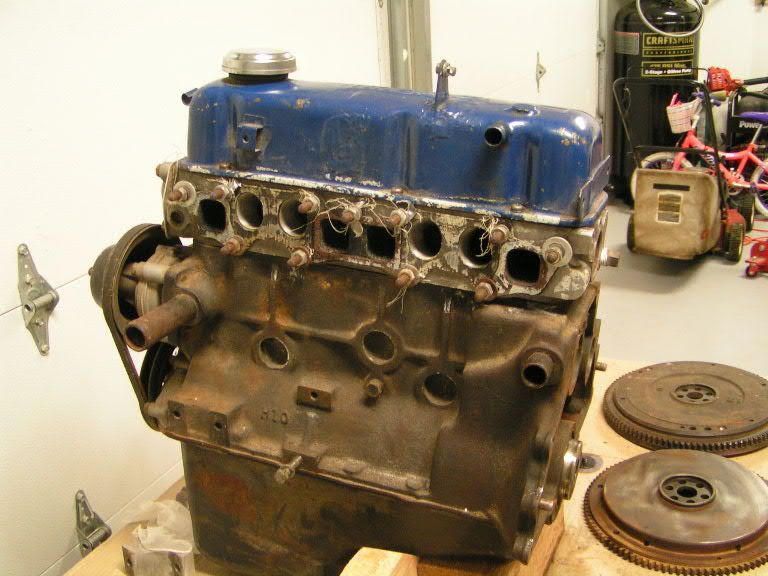

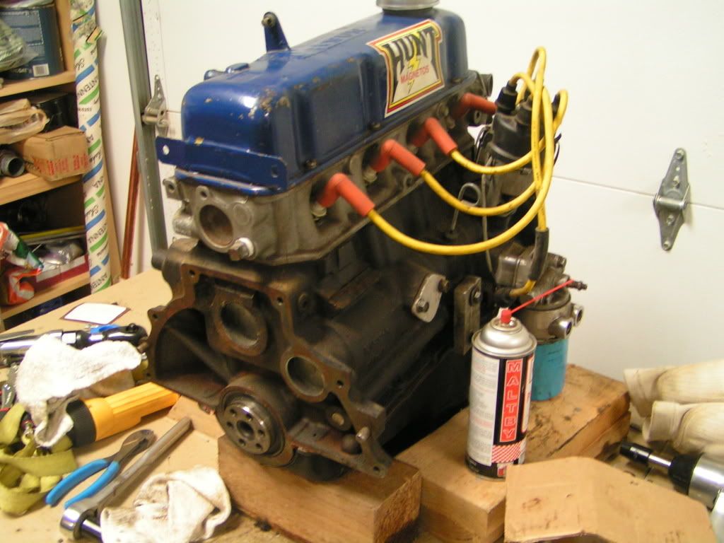

heres its future motor, a little clean up & it should be grand!
So, there she is in all her glory. I've sworn this will not become one of those projects thats still not on the road 5 years from now. I plan on having it painted by summer & on the road by hopefully September. It's a lot of work but should be worth it.

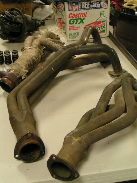

does anybody recognize any of the headers or the valve springs, I was told the springs were Datsun comp 1200 GX, I'm assuming thats correct.

Good on ya, especially that 4.375 gearset.
The valve stem seal is stock Nissan type, they work good if you fit brand new guides to the heads. Otherwise use the umbrella ("ford" type) seals, they work just as good and continue to work even after the guides wear a bit.

4.38, hope it came with a 5 speed, or at least you can get one.
nice find though. good luck and looking forward to pics when its done

I made the stands as welding project to brush up on my welding skills & to get familiar with the new welder, it helped quite a bit. They work very well, the car moves in every direction so its easy to maneuver around.
