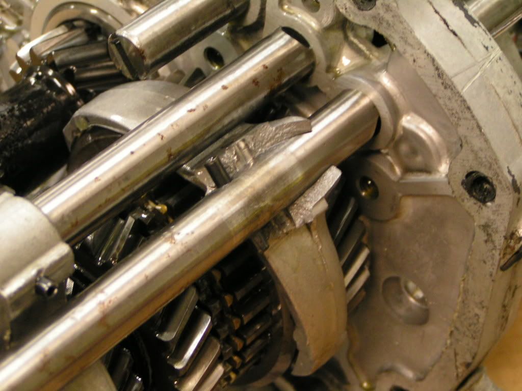

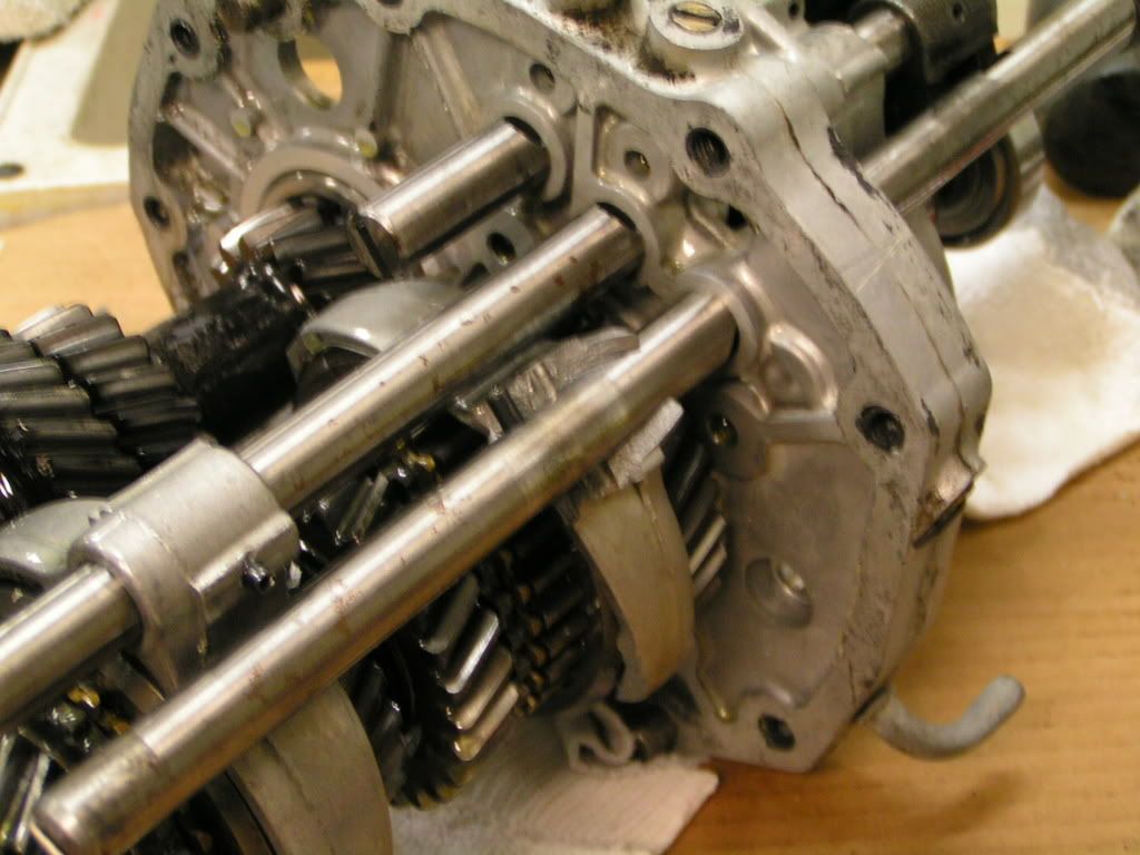

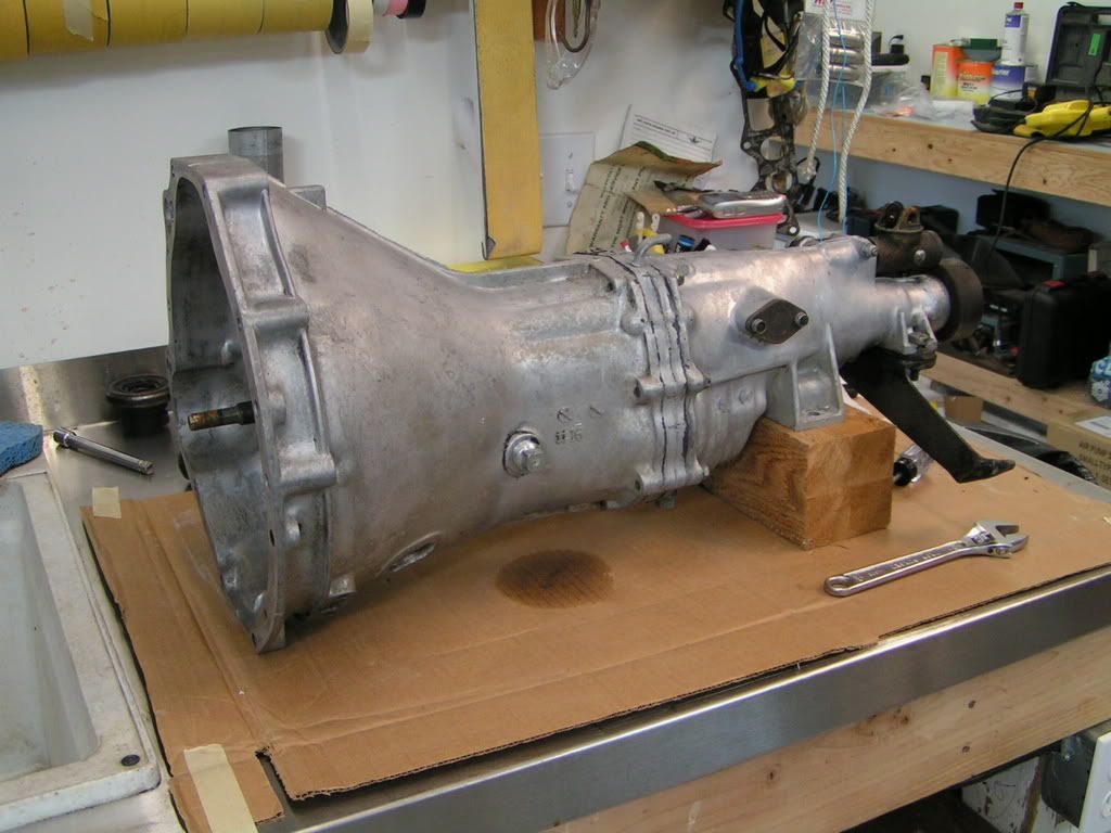

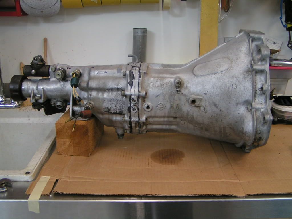

picked this up with a 79 210 I bought the other day for $140 bucks! It was the main reason for buying the car...
I knew it had a shifting problem between 1st & 2nd so I tore it down to find out...
As you can see I need the shifter fork for 1st & 2nd, the real question is can I buy on of these new anywhere?
alternatively, are there any other transmissions that share shifter components I possibly could still get hard parts like this for, say from a Pulsar or something?
Anyone have any ideas, I'm all ears!

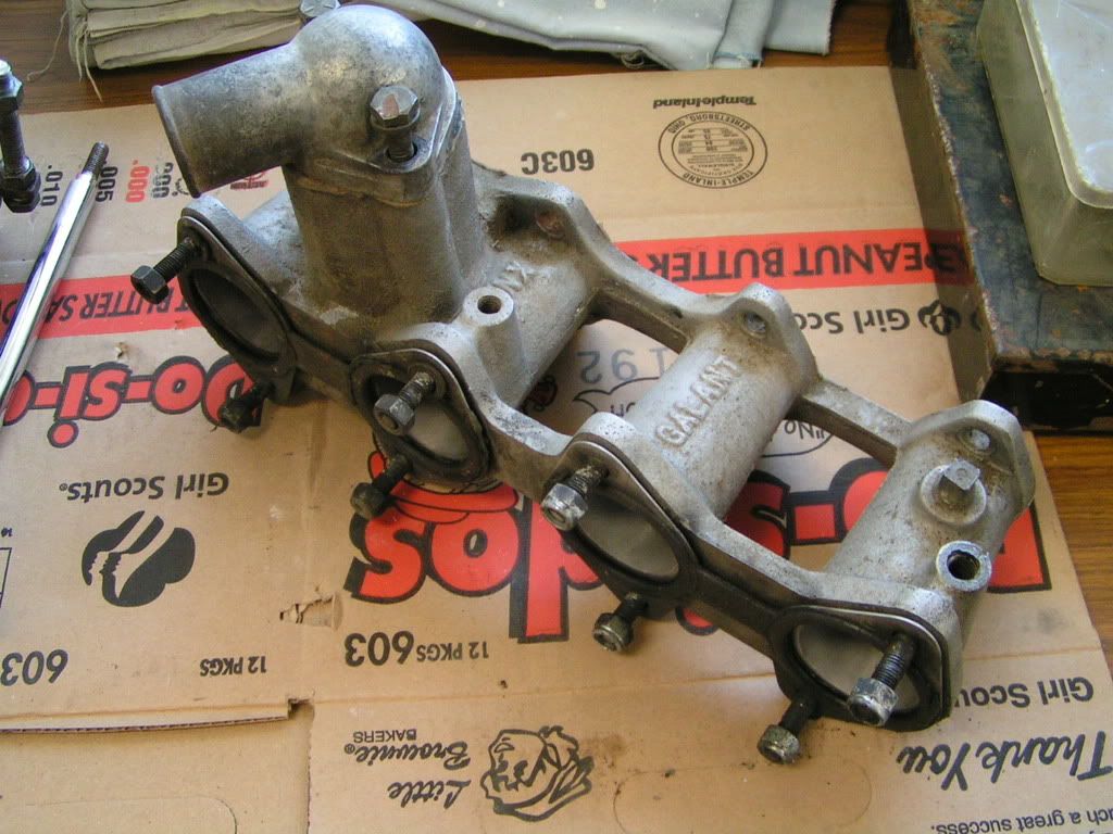

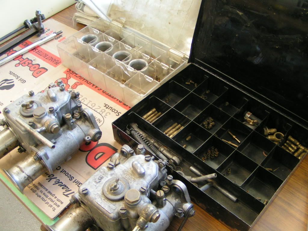

Oh yeah, got these too the other day, 2 DCOE's & a boat load of jets & such...
this happened to come with it, I'm told it fits a Dodge colt/Mitsubishi engine
If anybody can help that'd be great.

The selector fork from 60 series four speed should be the same. I wouldn't know what the availablitiy of those would be in the US. Over here (NZ) you can pick up a C20 vannete box for peanuts.

i would say those sideys come off that manifold and that they come off an early GT galant coupe .... 1976 Chrysler GD Galant maybe . nice pick up !

####, I've thrown away complete low kms vannete boxes before. (Like 140,000 kms)
We got very few (car) 60 four speeds here, (I've never seen one) but truckloads of vannete ones. It's really only the tail section/shifter set up which is different.
I'm sure one of the Aussie boys will have a shed full of broken 60's. I could probably hunt down van box at a pinch, but taking it apart to get the fork out is no fun. Let me no if you draw a blank, and I'll put my feelers out. In this day and age, I'd say it's deinately well work fixing though.....

It looks like i'm getting lucky again, I may have found all the parts new from Nissan, I'll know soon.
What the hell do I do with the Galant dual manifold?? Any forums for those guys?
