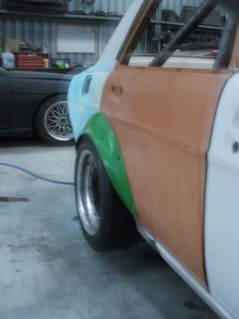

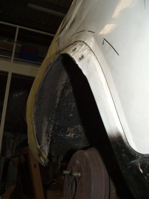

This was with oxy hammer and dolly, I needed more room in the end so I just cut the whole thing off and used a fibreglass flare.
