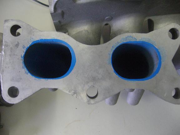

yes i have a ca18 head with the plenum and runners all match ported i havnt had it flow tested but it must be alot better than standard
this picture shows how much needed to be taken out
the left is stock and the right is ported

dont need to block holes between ports. they may create a little turbulence but you woundnt notice.anything used to block holes could dislodge and suck through engine.
must block holes to outside to prevent air leak.
have you run the car with all this working?
i am interested to hear what difference removing it makes.
the most benefit you will get from porting is the area closest to the valve seat.

dazza i havent run the car yet but on the manifolds i removed up to 6mm of mismatch which i think is huge... that was on plenum and up to 2mm on intake ports bolting to the head.... surely that much will do something will find out when i rebuild the engine i suppose.
