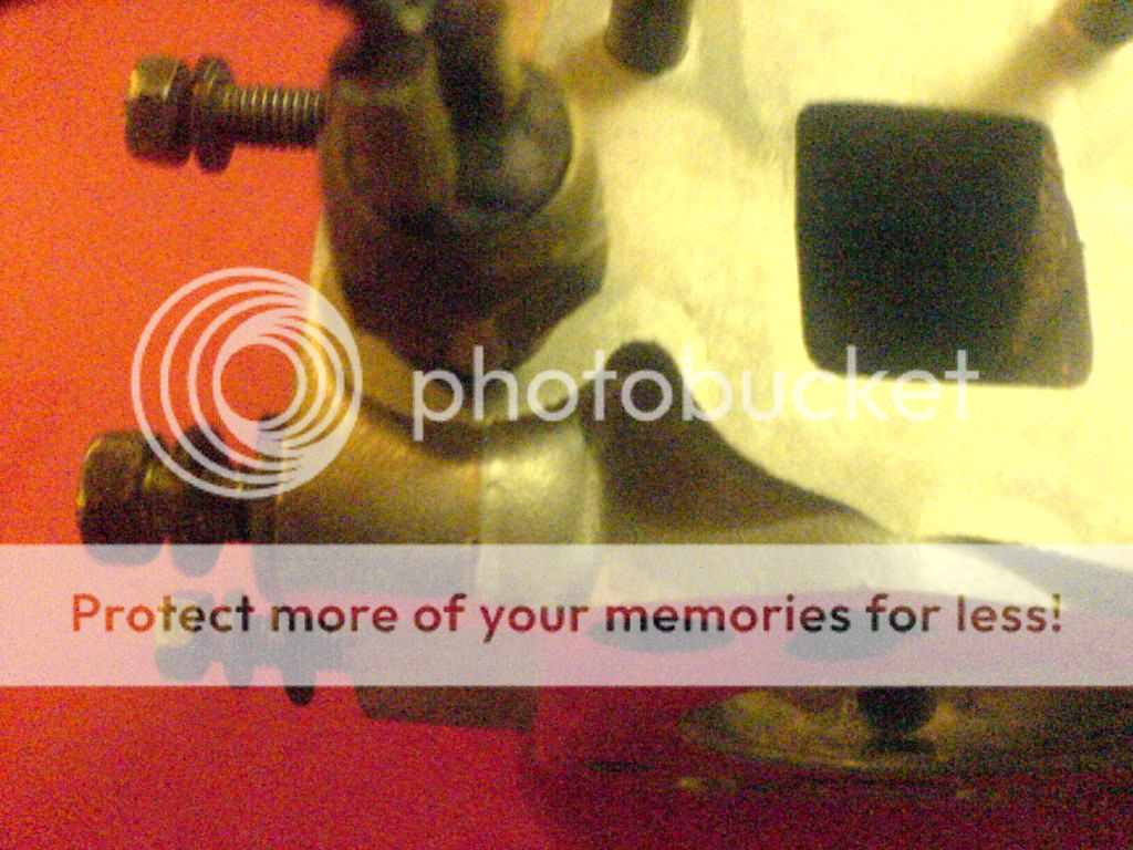

Hey all
Thanks for the head bolt info. I now have another question
With a head shaved as much as in the pic below, will cold valve clearances be altered from stock?
I've just set mine and the valve train is very rattly
Cheers, Jon

The thickness of the head wont effect what clearance your tappet clearances should be adjusted to. Just set them as per either the factory specs, or as per your cam card if you're running a reground/lumpy grind.
