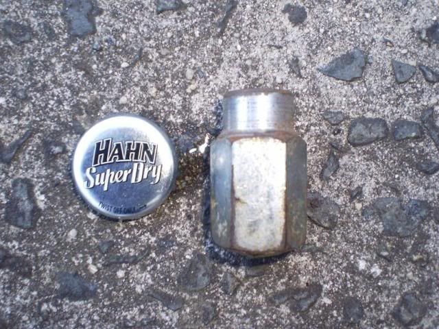

you need nuts like these
best option is raping a trx or et pulsar at a pickapart they not that cheap new.
they look good but drive #OOPS#.

apprently there are two different styles of wheel nuts to suit them. i have two sets of trx wheels and they require different wheel nuts/fitting.
i ended up making custom wheel nuts for the set i got off greendog.
