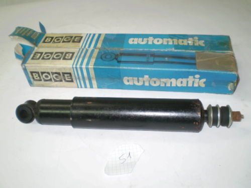

Other, Rear: Boge part #: 1-0391-27-482-0
I got a set of these from ebay, I am still waiting so I will post again when I get them to confirm if they fit.
