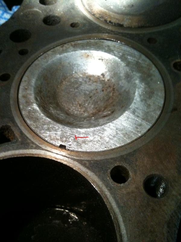

Hi Guys
Sorry if i disturb this topic , what this no in the piston means (that i have highlighted in red on the top of the piston) ?
thanks

Sumith,
quite often when an engine is rebuilt the mechanic will number the parts so they know where they came from.
Posted on: 2010/7/15 10:35

hi ssskiwi
means that particular piston is belonging to which cylinder etc ?

Yes, it may have been pulled down to only re-ring it if the bore and pistons were OK. The pistons, rods and caps will all have been stamped with the cylinder number etc..
