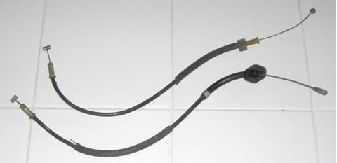

How does yours not fit?
Notice that B210 and B310 use the same end at the carburetor:
Posted on: 2011/8/6 5:28
Re: WTB:datsun b310 accelerator cable??
2011/2/12 10:31
From vic
Posts: 649
hi the end things are same but see in circled black the metal crimp isn't the clamp supposed to be thier but mine is on the red part so when tightened it makes the accelerator bind at half throttle!
jpg  15318.jpg (16.06 KB)
14954_4e3cc64d73838.jpg 480X233 px
gif  15318.gif (37.01 KB)
14954_4e3cc6c9822ab.gif 480X233 px
Posted on: 2011/8/6 5:44
So your cable doesn't have the part circled in black? In that case, get a new cable.

2011/2/12 10:31
From vic
Posts: 649
hi i might not be clear enough when i explain!
it has the thing circled in black but in the wrong position when u put the cable in the throttle cam the metal thing is too far forward and the clamp on the carb is too far back so it ends up being clamped on the actual cable making it bind!
