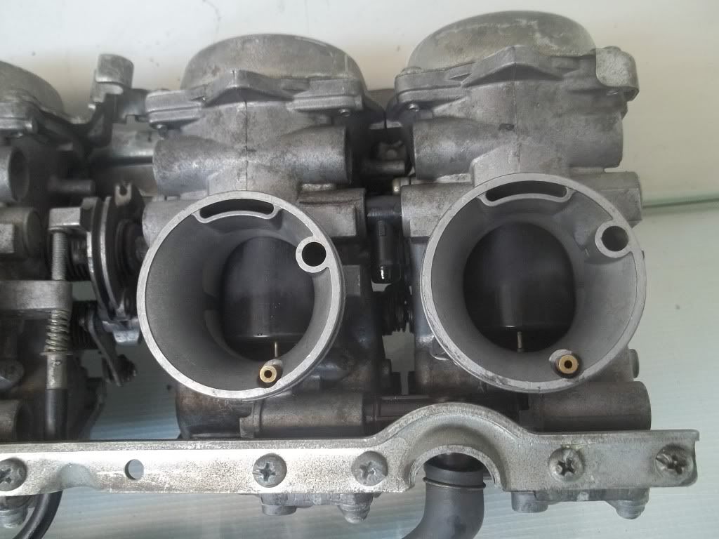

If anyone is interested I have a set of
Quad Keihins 41mm (Honda Hurricane 1000)
They are VGC condition with cable
for choke and accelerator in the right
place for a datsun setup.
Just need to make a manifold that can
angle them as the flat slides sidey
has pictured and get them tuned to suit.
Im after 220 posted within Oz.
Accelator cable provision picture above
Posted on: 2011/9/16 1:41

Bakat, Im sure you can get them cheaper there?
Yes Andy I did a crude job on that old manifold
but using the 36mm ones back then seemed to flow
as good as dcoe40s on my a16 before spliting bores.
