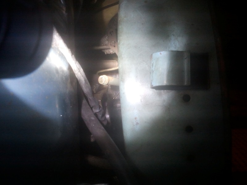

Other than that, Ive got this pipe coming out of the air filter enclosure. Can i just block it off? Would i have been losing vacuum from there?

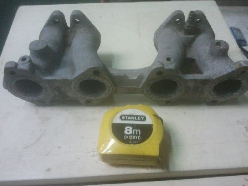

Oh.. and what is the intake manifold and how many millions of dollars is it worth. I got it in a box of spare parts.
