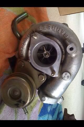

i have a so called "t28BB" here, but want to confirm
went to nissan silvia website but every next post contradicts the last
anyone have an easy way to check, the ID tag is missing unfortunately
there is shaft play in that the wheels can move laterally in the housing, but no movement longitudinally (aong the common shaft)...should i be worried about the condition of it or is some lateral movement accepted as normal?

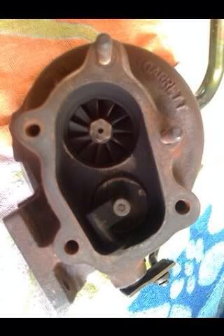

T28 brush bearing
T28 ball bearing
Posted on: 2012/6/9 14:20

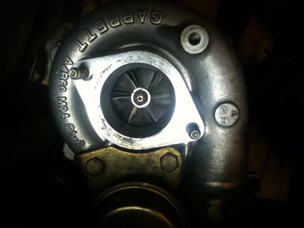

easiest way to tell if its ball bearing is where you bolt the chra to the turbine housing, 360 degree thrust bearing will have 4 bolts and ball bearing 6 bolts like in the picture. i circled the ones im talking about

sweet, mine is 6 bolt, any comments on the shaft play?
Posted on: 2012/6/10 7:04
1200 Coupe Weekender
1200 Coupe Rallycar
1200 Coupe Wife's Daily
1200 Coupe Project A15ETT
Re: t28bb identification help please
2007/8/23 12:05
Posts: 1021
well usually as long as it spins freely and there's minimal movement it should be fine, its hard to say without out seeing it. what the compressor wheel look like? not discoloured or anything? are the edges smooth?
