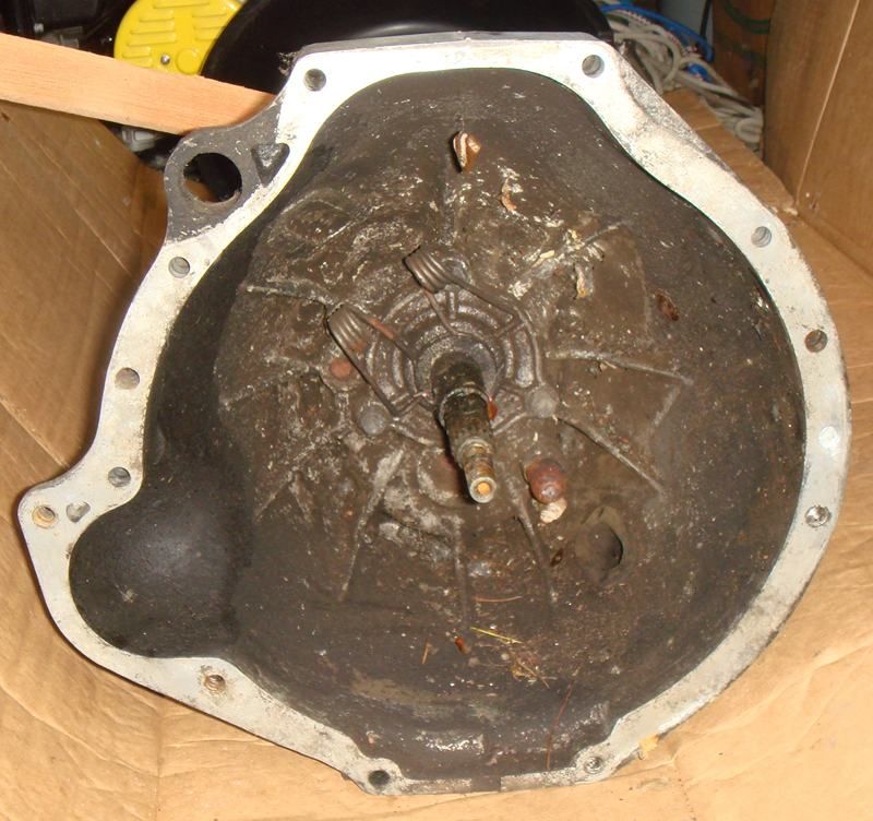

Hey all, My gearbox whines on decelleration only?
Tech wiki says worn input shaft bearing
Is the input shaft bearing the splined shaft that is visible when the engine is out?
If so, how do i replace the bearing?
Thanks, Zak

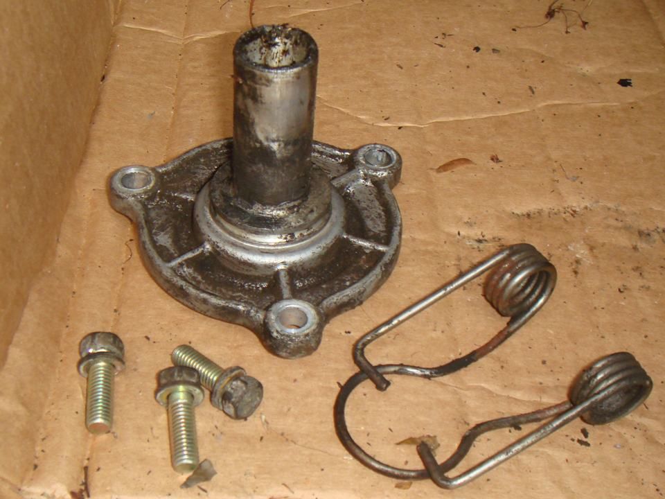

The bearing hold the splined shaft in place. The bearing is not visible even when the transmission is removed.
The bearing is behind the Cover snout
