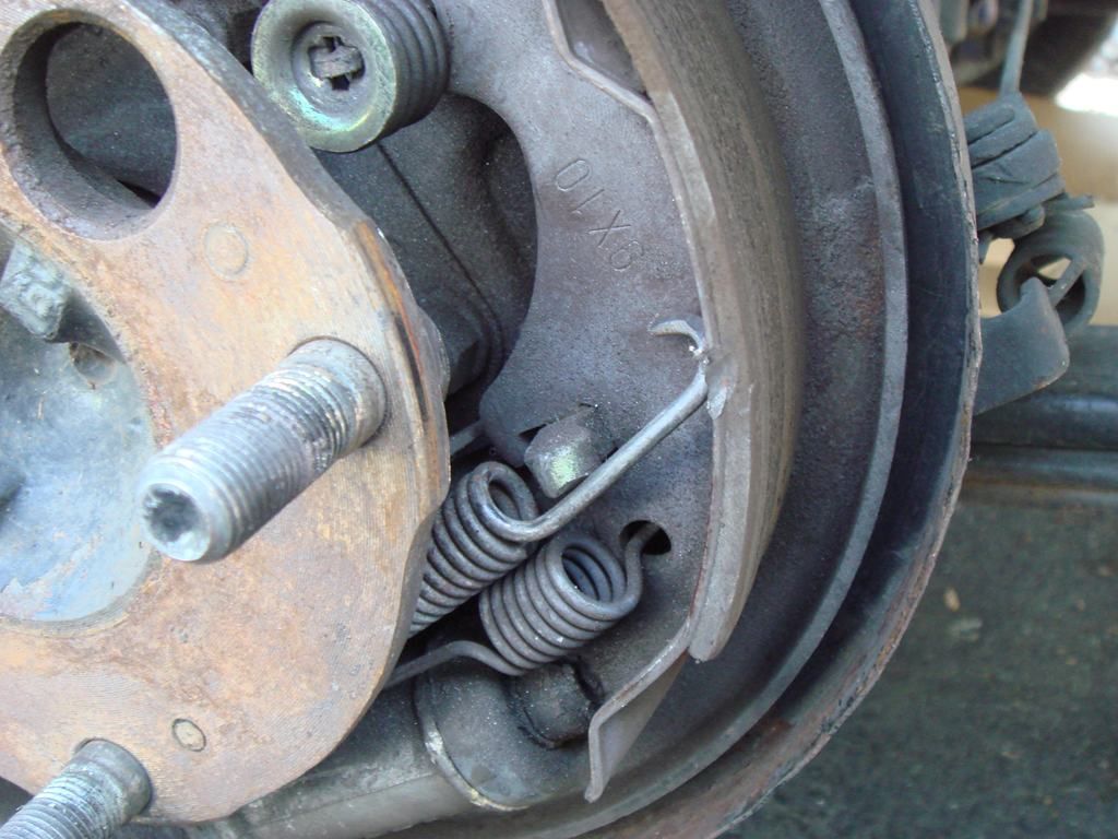

Found this, i'm hoping it is the entire cause.

Looks a bit different to my ute, on it the large spring goes on the bottom, (near the slave cylinder, and the small springs go at the top. Also the handbrake lever comes in differently. Hope it fixes your problem.

WOW! Thats dodgy, lucky it has worked so far.

Nah, the brakes are correct, just that the spring snapped off. They are self-adjusting brakes like the N10 Pulsar.

Oh, the top spring snapped off?
Glad its not a diff issue.
