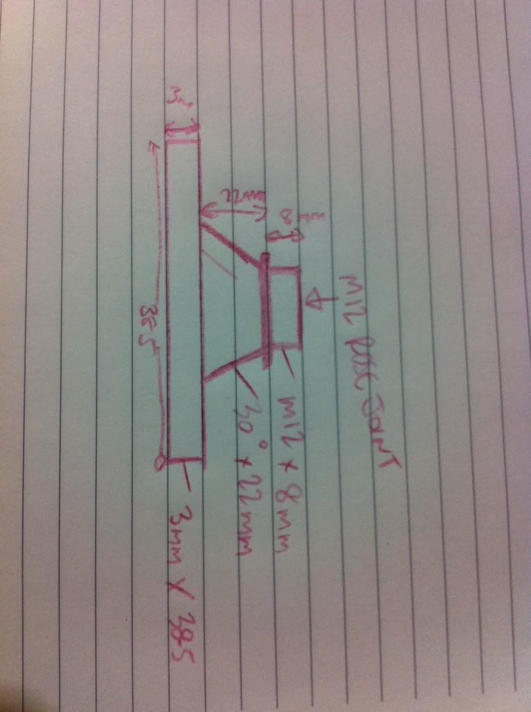

I have a 2 piece setup at the moment and want to make it one piece, I'm using a m12x38.5mm washer and  Rose joint spacer with these specs
Hole Bore:   0.500"    ( 12.7 mm)
Width :          0.437 "   ( 11.11 mm)
Height:          0.875 "   ( 22.22 mm)
Taper:           30 Degrees
  but I really want them to be out of one piece of good steel

I'm going to need a drawing with the dimensions on it , that way we are on the same page before I start cutting metal . If you like I can send you a sketch and you put the sizes on it

Perfect , what size hole ? And how many ?

M12 is the rose joint size and x4 would b grate :)

Ok we're not on the same page yet with these spacers , what size bolt are you putting through the spacer? If you are using a 12 mm bolt that means a 12 mm hole that means the 12 dia by 8 mm section on your drawing will not exist , do you follow?
