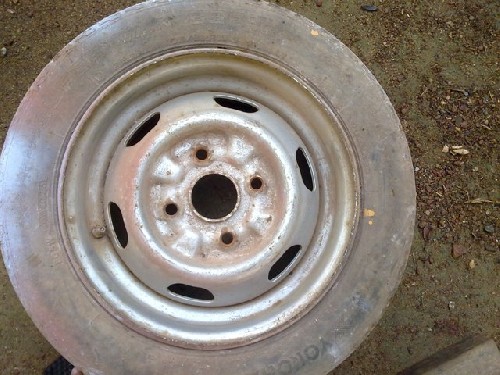

Hi Guys
i got 4 13.5 Rim set that match my bolt pattern and also i got 4 used tyres of (165/70X14 Japanese Yokohama), will i be able to install them on my 13.5 Rims or do i need to buy 14 Size rims for them ? if so what model vehicle rim will be fine that uses rim size 14 ?

no offence, but thoes tyres look pretty low in tread anyway.
13.5's onto 14's sound sketch.
best just getting a new set of 13.5" tyres man to suit your 13.5" rims.
but i don't know where you'll find them?

14" tires require 14" rims. Put onto any other size they will immediately fail.
Do you mean 13" diameter x 5" wide? Because I have not heard of 13.5" wheels.

The Tires i am running are much verse than these since i got them free just thought of finding a way to use ,ok might be i am mistaken i might have 13.5 Tyre on 14 Rims any way i have seen some 13.5 on the tire or rim i will confirm it by checking them ,
here it is it looks rim are wider the tyre is 13.5 low profile

As dd said I don't think there is any such thing as a "13.5" rim.it would be a 13" tall rim 5"" wide.which means you need 13" tyres.pretty positive there's no such thing as half sizes

Look at this tyre, it says 175/60X13.5 so what is this rim size then ? there is no indication on it is it 13 or 14 or 13.5 ?

Looks like it is a 13.5" rim. L.T. (light truck) tires are available here in 16.5" size (they stopped making 16.5 wheels in the 1980s, but this is the first I've heard of 13.5". It will require a 13.5 wheel (which should be stamped on the rim). Won't fit a 13" or 14" wheel.
Never seen one before, but they are listed on some web sites, such as Trademe New Zealand
