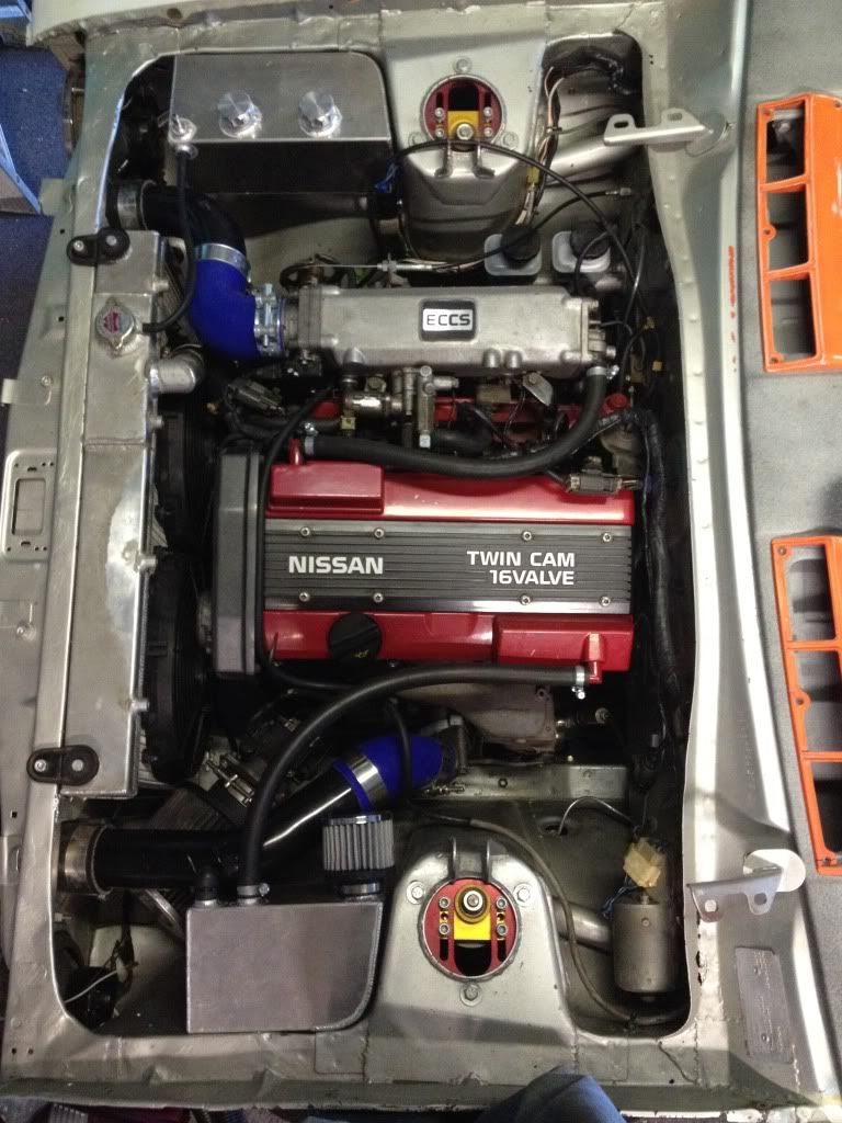

2008/6/15 9:11
Posts: 4504
Mine are technotoytuning t3 tops for a 1200 I have 200b struts and stock control arms and get about -2.5* camber
Posted on: 2014/3/17 7:57

From brisbane
Posts: 253
Wow that looks like a lot. Although the 200b lca's have the longer ball joint don't they. You are probably 50mm wider at the bottom than I am so that probably explains a lot. Thanks for the pics.
Posted on: 2014/3/17 8:12

2008/6/15 9:11
Posts: 4504
Those cambertops have a lot of adjustment over s13 ones
Posted on: 2014/3/17 8:17
