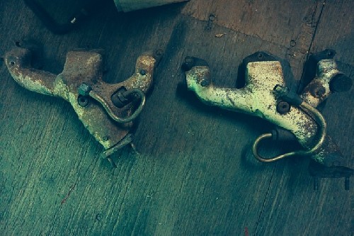

Here are the first two, others are buried. These both came off A14E, see the outlet angle differences.

Both manifolds feature two external ports, other than the main outlet port below.
The manifold to the left is pictured installed in the image below. Note the early A14E had a more regular look rocker cover.
