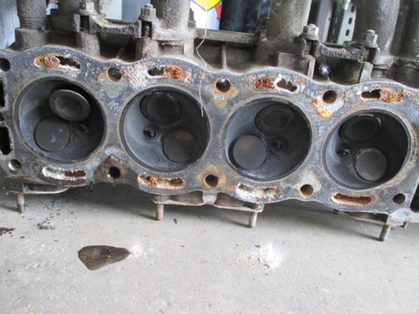

just looking at Prince G15 and G series G1 model and cant help Nissan used alot of Princes finer engineering ábility and racing designs for later Nissan Success.
Prince GTR started its venture into its now supercar GTR status for Nissan really after it acquired the Prince brand.
After all that this head has great design header like the GX A series
http://page19.auctions.yahoo.co.jp/jp ... 595300?u=%3bautowave_0716
and a few other things like an AY style head back in the early 60s.
http://page19.auctions.yahoo.co.jp/jp/auction/x391595292
could it be possible Nissan just lifted the G1 75mm bore matched cylinder head and used it on an A series? a good mystery for those after the AY style head as the G was OHV but maybe not crossflow like the OHC series.
https://en.wikipedia.org/wiki/Prince_G_engine

http://auctions.c.yimg.jp/images.auct ... 600x450-2015052000084.jpg
http://auctions.c.yimg.jp/images.auct ... 600x450-2015052000063.jpg

Re: Prince G series engine close to AY?
That crossflow hemi-head looks awesome!
The exhaust manifold looks very close to an A14 manifold
2002/10/28 6:49
Posts: 10926
Prince made some good Hemi style heads surely used by Nissan later
