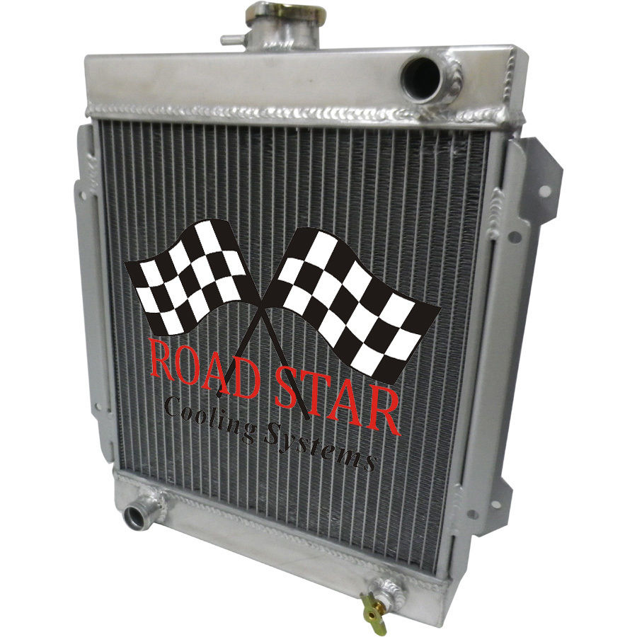

Bought a new aluminium 3 core radiator today and it solved all my issues :)
Picked it up for $139 at there warehouse @ Roadstar Automotive in Hornsby heights!

Good price, and 3-rows indicates it should cool better than new stock radiator

Those Ali fleabay radiators work a treat. On the 1200 you either have to space it out by 6mm, or lift the holes 6mm to make it fit - no big problem for the gain
Did you have to do it on the b210?
Posted on: 2017/1/27 6:40
keep it simple
Re: Datsun 120Y / B210 OVERHEATING .... help!
2015/8/2 9:49
Posts: 119
Top bolts fit 100%
I haven't got any bottem bolts in, for the moment i have cable tied them till I get to work then I need to move the holes to suit on the bottem
