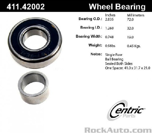

For the late 1200 these are "sealed". Does that mean permanently lubed?
NTN bearing
jpg  411_42002.jpg (42.66 KB)
