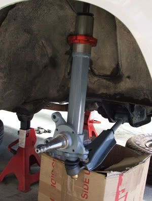

2004/10/28 11:35
From Geelong, Vic
Posts: 6184
mine and unfams cars are running basically the say struts
stanza/200b struts, mine are cut down stanza ones with corrona inserts(very low ride height needed) unfams ones are 200b or stanza struts cut down to suit 240z inserts
both are using ebay spec alloy theads and perches with custom top perches on mine and tein top perches on unfams
the collars were a rather neat fit on the strut which was good, so i just welded a step onto the struts(bit of cut down pipe so the top is flat) for the thread to sit on and then used grub screws in the top of the thread to stop any rotation and movement upwards
so far they seem to be working all good and seem to be decent quality material....fr all of $100 to do both sets of struts neither of us are complaining
coz mik has a pic...i'll out do him , man my brakes look small
Posted on: 2008/11/13 10:59
