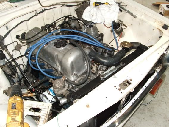

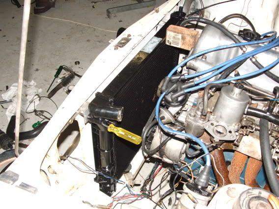

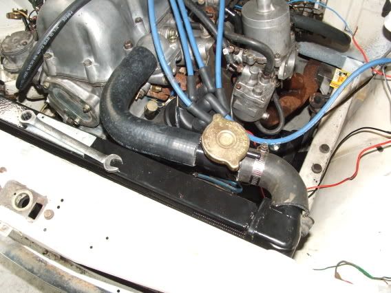

A bit more done, and i fired her up today, only for a few seconds, just set the timing and dwell, will have rad completely hooked up tomorow night and clutch bled and then give her a tune, which will be fun!
