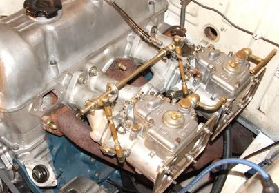

engines looking real nice now
wish mine had a head and carbies like that

Posts: 3931
Im getting so much closer! Thermostat housing, hook up throttle cable and time dizzy!
Still waiting for my springs, i ordered them on friday so should get them this week!
Ive been around the block with the Su's and its great to drive, even though it was raining, so much more torque than the a-series, with 12in stockies and drum brakes, not too much traction.

Heres a pic of my new carbs.
L18B110 I didnt end up taking pics of the cams. I replaced L20 cam with the original cam, they both have U20 stamped on them anyway.
