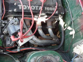

i done a gze in my 1200 ute...
MYSELF START TO NEARLY FINISHED
any 4a engine has a similar block even 20v so engine and gearbox mounts will be same with all these engines
also the gearbox combo will be same what ever way you go.
for the price
go a gze if you want a turbo or supercharged or both.
go the silver top 20v for a good na engine
but this is only if you want to go with toyota...
if you have to do engine mounts and the rest of it choose a engine you love as it will be the cheepest thing to buy for the conversion.
the mounts will cost more then the engine if you cant do it your self.
And gearbox combo is like any engine
run a week t50
or custom supra,celica,corona setup like any high power rotor or sr or v8 etc etc.
hope that helps

Sorry its not the best pic.

it was build for the owner not for me thats why i own a datsun Quote:
Tyrie wrote:
respect for building that dude, its a work of art, but gemini's are the sworn enemy of the datsun
Posted on: 2007/6/22 13:26

thanks guys for the reply and the help that you guys have given me.. and for the gemini engine bay i was just putting that pic up as that is one of the top engine bay that i have build along with a few others.. but thanks again for the replys.....
