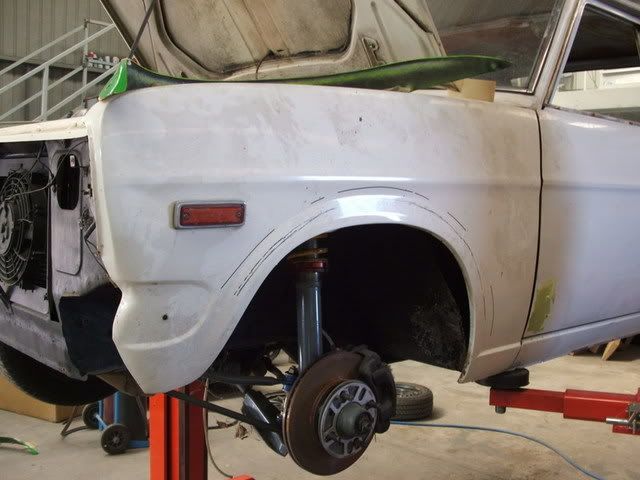

Is it? Fark! Maybe there is some way to do it. I'll have to grab a z steering arm when im theiving your 260c hubs and see if i can make it work somehow.
I can fit 15's over the wilwood setup according to the blokes who make it, he reckons some 14's fit too, thats not coming until its atleast done a few years racing and I decide to build the L24 turbs.
17's are gay.
Tuf110;
Heres a pic of a stanza strut,
280zx strut
Posted on: 2007/6/28 11:08
