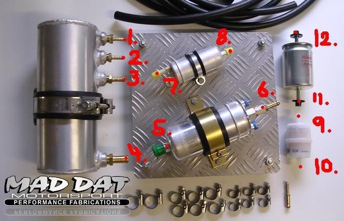

1 = OVerflow to fuel tank
2=from fuel rail return line
3=plug into 8? (pumping side of lo press pump)
4= Plug into 5 (in of fuel pump)
6=into 11?(inlet of fuel filter)
7= suck from fuel tank
put 9 & 10 between fuel tank and lo pressure fuel pump
12= goes to fuel rail.
Make sense?

Fuel System.... what goes where...
2005/12/31 1:39
From Adelaide
Posts: 283
hey everyone
can someone please help as to what goes where on here??
