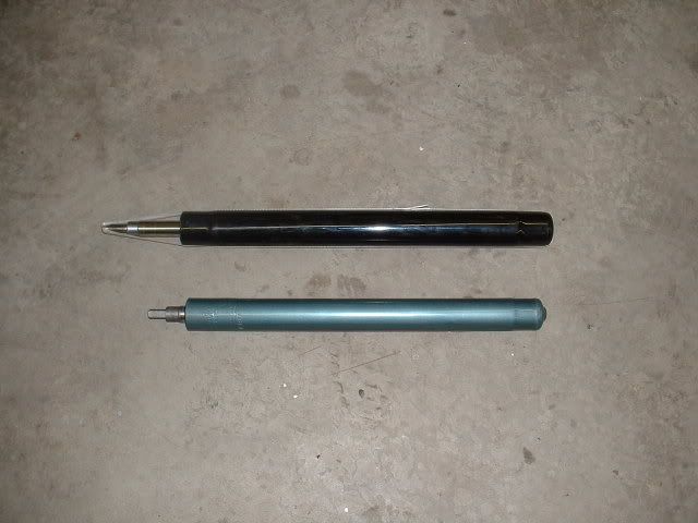

Re: Lowering the B210?
2005/8/6 1:53
From Selah, Washington
Posts: 640
Strut measurements (from end to end of shafts)
Hope this helps.
1200...Monroe Part # MC-818 (CUJO3M)
OD 1 1/2"... shaft is 3/4" closed 18 3/8"
open 25 9/16"
B210 for a 1977
Gabriel... Part # G44753
OD 1 9/16"...shaft is also 3/4" closed 19 1/4"
open 26 1/8"
Sorry I could not find my digital calipers
Posted on: 2008/2/18 3:32

Hey,
I need help with a 74 B210 Honey Bee w/ an eibach coilover kit and the stock inserts. I need to find out how to do the mods of cutting the strut down and which inserts to use. right now it needs to go 2" lower w/o bottoming out so much.

Im pretty sure it was the later model B210 (74+ or 76+??) that went up to the larger diameter strut tube, balljoints got the larger bolt size and pattern as well as getting the matching lower control arms and steering arms.

Can you measure both and post here? Most outside diameter of the inserts, but length, stroke and shaft diameter will be useful as well. Thanks in advance.
Posted on: 2008/2/13 7:49

I have new in the box inserts for both sets of struts B210 and the B110 also

Where is the bearing in each of those? Exactly the same place? Or lower in the B110 hat and higher in the B210 hat? That will make a difference.
Disc-brake B210s use at least two different strut sizes. Are the inserts really the same physical size?
- Australia B210s have small diameter struts (45 mm, same an B110)
- USA B210s use the larger diameters struts (50.8 mm large Datsun size)
Strut Inserts.
But apparently the hats interchange.
Posted on: 2008/2/13 7:25
