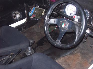

i should add i chopped mt stick ( shortened) and fitted it backwards to make it more foreward

heres one of my ute

A 1200 with CA and stumpy box, the shifter sit about 50mm back from the center of the current shifter hole in a standard tunnel.
If you use the CA box, it will be about 150mm back from the original A12 shifter.

i can take a happy shot when i get home of where the gear stick comes out of a ca box ( useing all maddat gear )
with the ca box, i had to move the hand brake coz it hits the stick

im chasing two photos one of a 1200 ute with a ca gearbox and one with a stumpy gearbox both of where the gear stick actually sits in the interior
