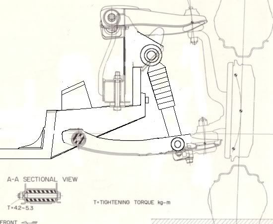

resurecting an old thread i may undertake this idea it would be quite difficult to make a decent mount easily hmmm ideas
Posted on: 2008/11/22 13:25
current project 4x4 patrol...
Re: B10 or 1000 afficionados - coilover mystery!
2002/10/28 6:49
Posts: 10926
Thanks Chris for the images
Here is the idea and the spring rates are totally adjustable with these little suckers as they are fully adjustable.
Using rectangular tubing with re-inforcing in the right areas will allow better clearing for taller engines and using thick solid washers welded thoughtfully then the mountings can be secure.
Posted on: 2008/4/22 13:17

beattie wrote:
Its not on the tie rod, its on the standard lower shock mount, just been rose jointed in.
yep I am really clever in case you havn't noticed.
Sounds good D, have you chosen your spring rates yet?
Also, do you think there would be enough travel to take a 1000 rallying? I wonder if this has ever been done?
Posted on: 2008/4/21 15:47
So whos gonna give it a go first? Doesnt look too hard to do really!

Yes no more restricting leaf style crossmember thats the plan.
Perhaps a smidgen of weight saving if done right with a well thoughtout replacement, then almost anything will almost fit darn it!
Especially tall engines that when tilted still give issues.
Ive bought some coilovers that handle 300kg each side so just looking for ideas.
Posted on: 2008/4/21 11:32

so with coil overs no more leaf spring? so you could cut the x member?

are you going to switch to coilovers D?
I am sure that you would be able to get a coilover to work, as they sell the same type of thing for light cars like clubmans, etc. You could modify the spring rate by the angle and distance along the lower swingarm.
It is interesting that the coilover is attached to the tie rod, I would have thought you would have gone to the swingarm... any thoughts?
