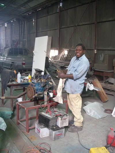

whos that in the piccy chris?

Sent 24V through and it fired after a few tries, sounds very, very serious. People in the workshop couldn't believe it was a little A-series.
She turns over okay now just on a small 12V battery. Putting the plumbing on tommorrow so I can run it longer and do some fine tuning.
The ground cam certainly gives a nice note.
I'm very pleased! gonna go and get on the turps I think.
Check out the batteries!!
I had to start it with a weber, sidedraughts don't fit with the extractors on.
Posted on: 2008/8/23 7:08
