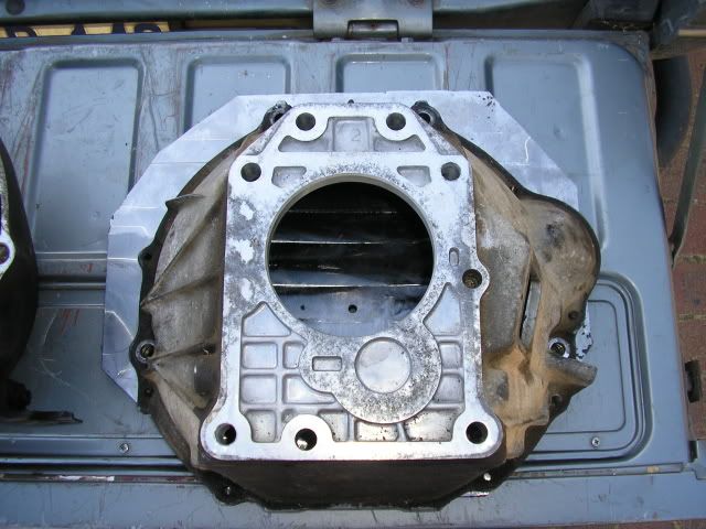

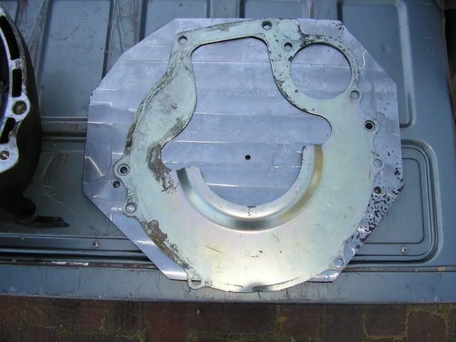

making an adaptor to fit toyota W50 5sp (steel case)
spent 12 hrs measuring both bell housings, clocking in and drilling the dowel holes in the plate
cutting out plate and milling both sides
but its all within 0.001"
nissan just had to make the CA a slant motor!!!!
ended up using the digital read out on the mill to do the angled dowel holes as a pcd
plate milled both sides and drilled for dowel holes. CA separator plate overlaid.note crank CL reference hole
toyota bell housing overlaid
more to come. need to machine dowel holes to finished size. drill and countersink bolt holes.bore starter location hole. grind both sides to finished thickness. bore out hole in centre. lightening holes.
dazza
