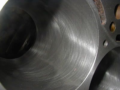

i took the engine into the reconditioners today. heres the verdict:
~ theres not much wear in the bore but those scores are deep and the cylinders need reboring.
~ the pistons have bad wear on them, probably due to overheating at some stage
~ there is wear on the crank but not much. enough to be able to justify grinding it purely because the engine will be under more stress than what it would normally be.
all up to fix that im looking at $600. i will get the head checked out just in case the overheating has damaged it.

holy freakin christ
whoever did that wants f#cking
i could do better with a brick by hand
find a machine shop with a sunnen hone
dazza
brown water jackets indicates air in cooling system
this is more like it
note cross hatch pattern(of which your pic has none)
