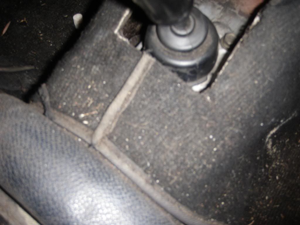

Yep the 3T fits with a bit of massaging. I had to cut/grind the old standard gearbox mounts out, the toyota box doesn't fit in between them, I had to cut out a sliver out of the tunnel for the clutch fork and the clutch cable, i re-welded a peice over it to cover it up. As Jordy said the shifter hole has to be cut about 50-60mm further back to accomodate the gear stick.Custom gearbox mount has too be fabricated of course, i just attached it to the floor by drilling through the floor and having a plate that is attached to the gearbox and a sandwich plate on the inside bolted both of them together.

couldnt get a pic of the clutch fork due to dark shed and #OOPS# camer

pics this arvo when i get home :)
