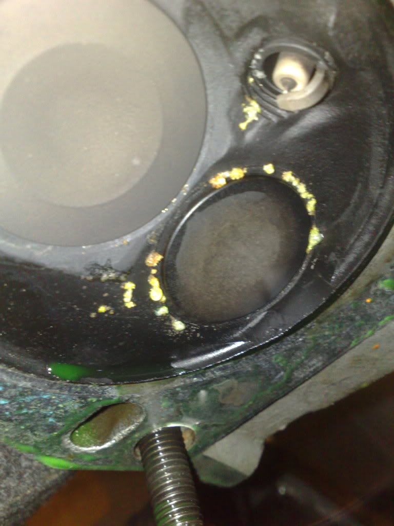

i'm gonna get some head studs but thanks anyway
and thats cool ... might have to make a new custom set then

I have some of those GX high tensile number 13 studs, if you are interested in some of them.
They are used.
About those extractors. One set I am using and the second set go into a 3inch leader (used on the racecar). So it is pretty massive, they are also custom made pieces so I'd rather not get rid of them. Sorry Aiden.

make sure you check the head is straight too

yea im going head studs and maybe a nismo head gasket

Coolant normally goes like that when exposed to air, that would just be from the head gasket leaking.
I would go head studs and a genuine or competition gasket, phone barry at datsport he can give you some good advice.

ok new problem, i've taken the head off and it looks like the head gasket let go because the head bolts werent torqued up (but i multi stage torqued them and its a mono torque head gasket, figure that one out) and now the heads off theres coolant everywhere so ive cleaned it all up and sprayed a lil crc in the bores.
anywho i found this after i took the head off
what the hell is it? looks like boiled coolant and its only around the valve seat
