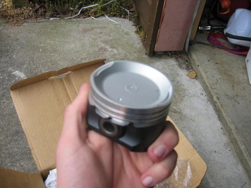

240 thou. (give or take a few) so that equates to just over 6mm in the new speak.

Thats not a big favour at all. I'll grab my verniers and have a measure up tommorrow. (If I remember. lol)
With the massive dish of these pistons, I'll likely wind up with a very low CR as you've pointed out. Hence I'll have to run insane boost.

Could I ask a big favour - could you take another pic of the piston with a steel ruler going down the side of it - the distance from the crown to the top ring land looks like it's almost enough that they could be machined down enough to fit into an a15

I'd like your thoughts on which cylinder head is going to work best in this situation.
In the future, I'm going to build a turbo A14. I was lucky enough to pick up these Open in new window
For a good price. They're unused, and have ceramic coated crowns and teflon coated skirts. E15eT pistons have the same comp height as the A14, but they have 10x the dish volume. This will enable me to run zero deck for good squish, but still have a nice low CR.
now the combustion chambers from this engine look like this Open in new window
[img width=300]http://kachi-snimka.info/viewer.php?id=cqs1252427541x.JPG[/img]
So considering people strive for nice small chambers on HiPo N/A motors to get good compression, what chamber configuration do you think would work best with these pistons?
I have a GX head, and H75 (40thou shaved) and numerous H89's. Considering the large surface area of the dish, would I be better to use a chamber that is open to mirror the piston?
